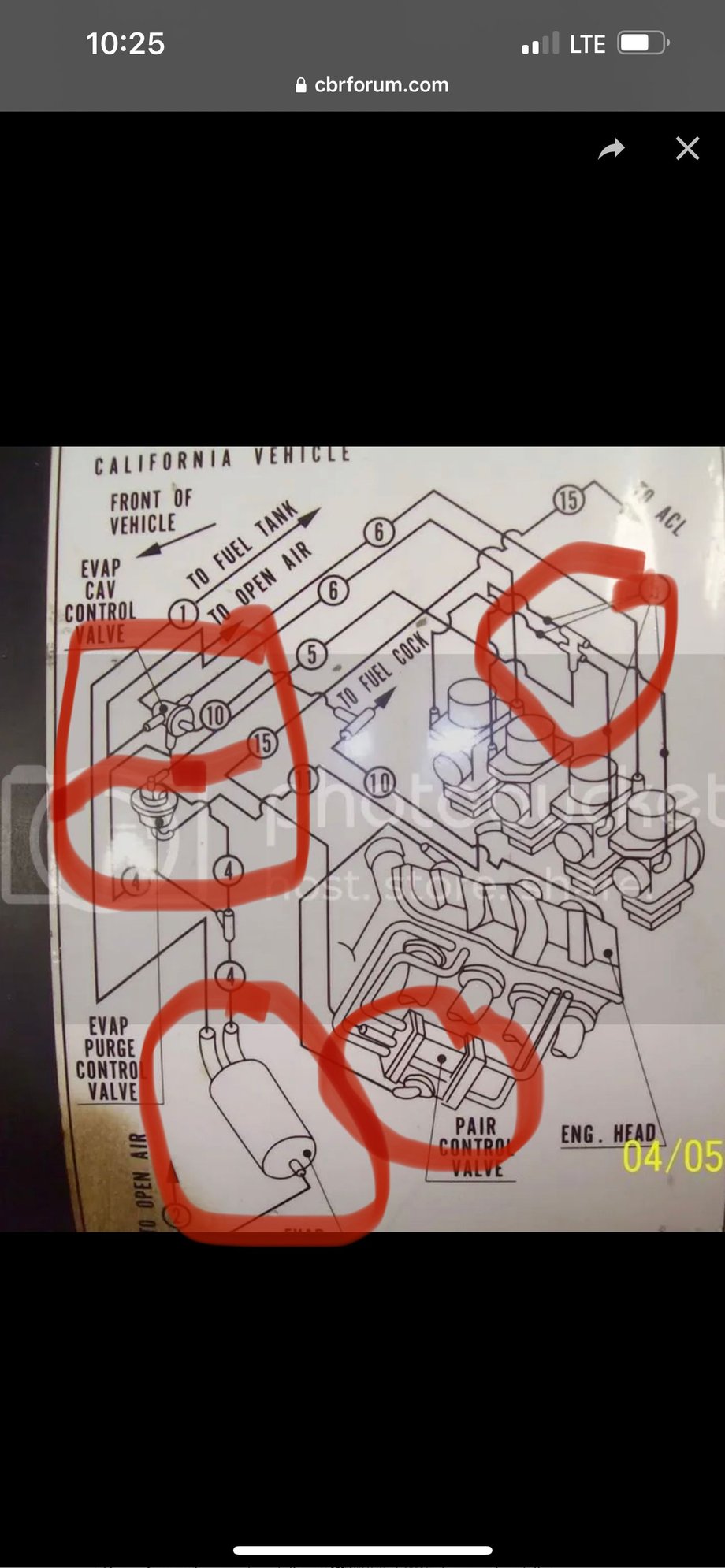

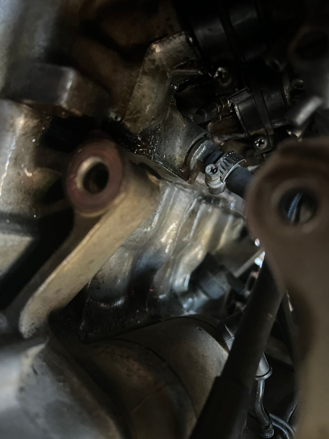

this is how it was leaking with the peckock on and trying to roll it over to start it would roll but not start and leak
i don’t have the parts circled in red

Those are only on CA models. Hoses on your bike won't have T fitting.
Petcock leaking externally is bad seals. Get rebuild kit to fix
