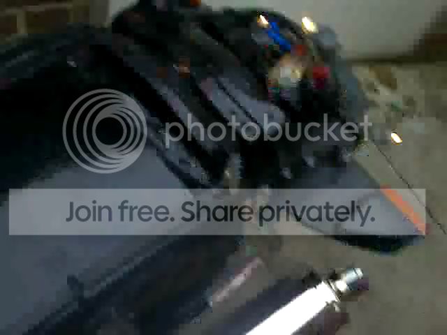

if it works a quick video of her first start up for a while with her new pipes
Video0000_zps6d613e96.mp4 Video by wheelnut8 | Photobucket
Embedded click to play
Sounds great Wheelnut. Can't wait to see her finished now. And glad you're going to hang onto her. An absolute credit to you determination and skill.
