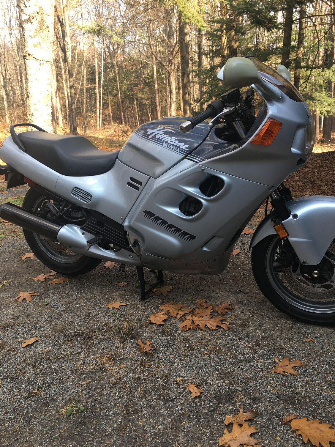

Default Running again
Bought a used box on eBay she’s running strong again. 65 degrees here today , had her out on the open road ,125 comes all too eas

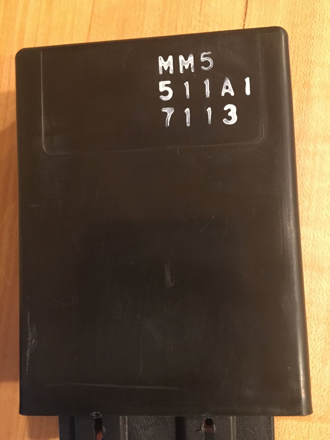

Old Nov 18, 2021 | 12:19 PM
forestfarm's Avatar
Joined: Jul 2019
Posts: 66
Default Box
